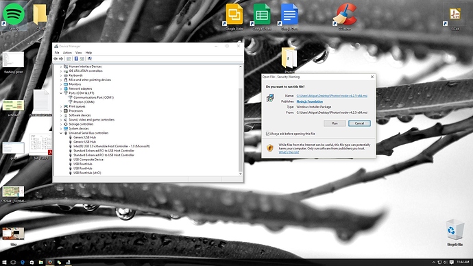

Yes I was directing Windows to the Particle drivers folder and that message on the image above popped up, however, @peekay123 just mentioned below your comment that USB 3.0 might give you problems, time to switch to usb 2.0. I will get back to you gentlemen in 2 minutes
@atiquechowdhury, you also need to MANUALLY select the photon driver, not just point to the folder. Windows is really stupid that way.
You might want to follow this for serial drivers:
Just make sure you use the updated files where necessary.
Looks like usb 2.0 recognized the device, what shall I do now? Is it better to install the node to older version* as aforementioned and then DFU Zadig?
