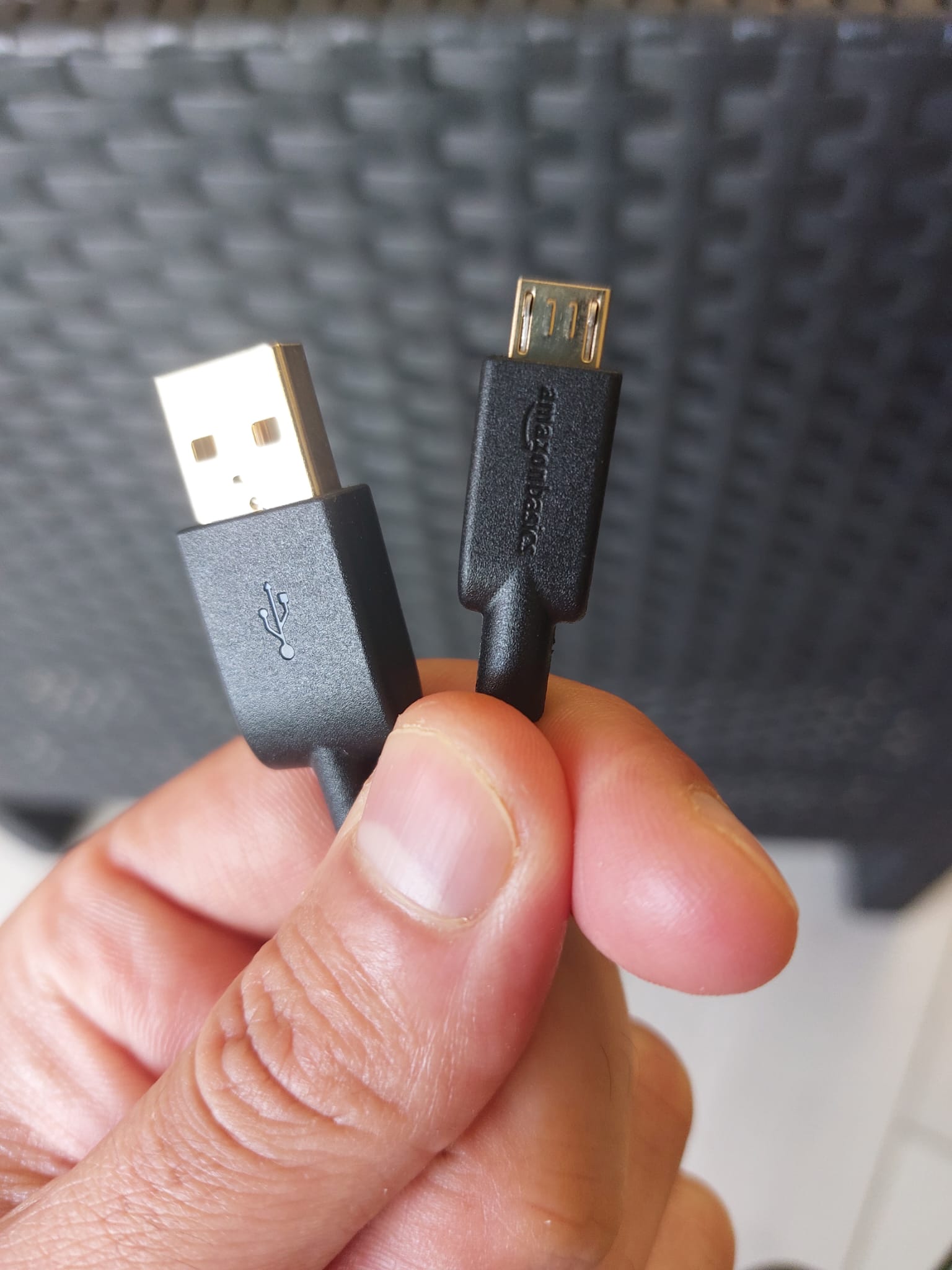

Also make sure your USB cable is a USB data cable and not a charging-only cable.
Thank @rickkas7 . My usb cable is this : (let me know if it is okey?) As well as I did particle cli wifi, it is refusing connect to wifi. what do you think about this?
OK, you're running Linux. The problem is that you need to install a udev role so non-root users can access the USB serial port.
