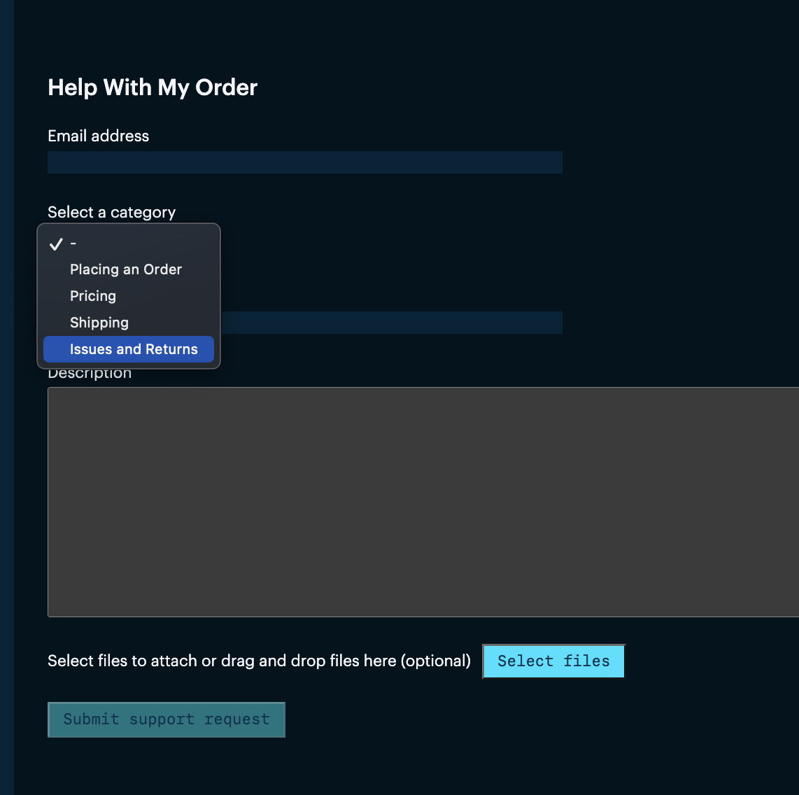

Hi @aab142 - can you open a ticket at support.particle.io via the following form:
and we'll get a brand new device over to you.
I previously used that form and was directed to this portal as "the" support process. I will try that again.
Let me know when you have and I'll take a look! You're certainly welcome to submit a return through our portal and I believe all should be working ok. I'll make sure the return is approved.
We received the ticket!
