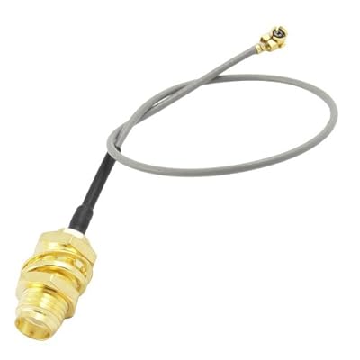

@douglaskbell, you need a uFL to SMA connector like this one:
and an active antenna like this one:

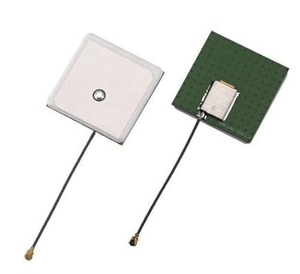

You can also go with this direct uFL antenna but at higher cost:
