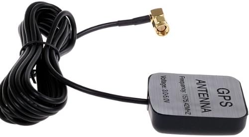

Can you post a link to your current external antenna? Small is relative and we don’t know how small you have it now.

This is the one i currently have

I have purchased a few more Active antenna’s but they are not getting brilliant results.
I’m using your code @rickkas7 - do you have information on what makes a good GPS antenna .
Like lots of things, size is important, but i’m looking for a happy medium. Ideally i want to be small, but also be able to obtain a GPS indoors / in a vehicle with 10 seconds.
