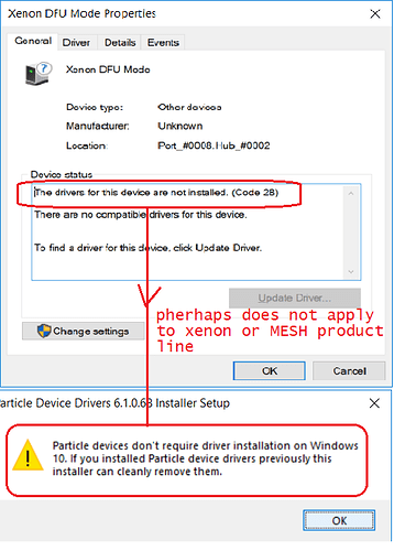

I received my particle xenon shipment and I am all excited to get it started. the same way I did photon setup the P-series Particle Photon I put it in DFU mode and using ATOM particle-dev-IDE Flash it with the code but not so fast… I use the same instruction to put Xenon in DFU mode and the windows10 does automatically recongize the Xenon in DFU mode just like photon and electron and the
So I run the particle device doctor since I already have particle-cli installed and the device doctor does require Xenon into a standard listening mode NOT DFU mode So I did reset it back listening mode
But without any luck
Yup, that message is a bit misleading.
It’s true that Win10 doesn’t require drivers for the USB serial interface, but for DFU it does.
Hence a new driver setup that delivers the DFU drivers for mesh devices is in the works and undergoing testing.
For the time being you can use zadig to install the DFU drivers (libusbK) for mesh devices.
