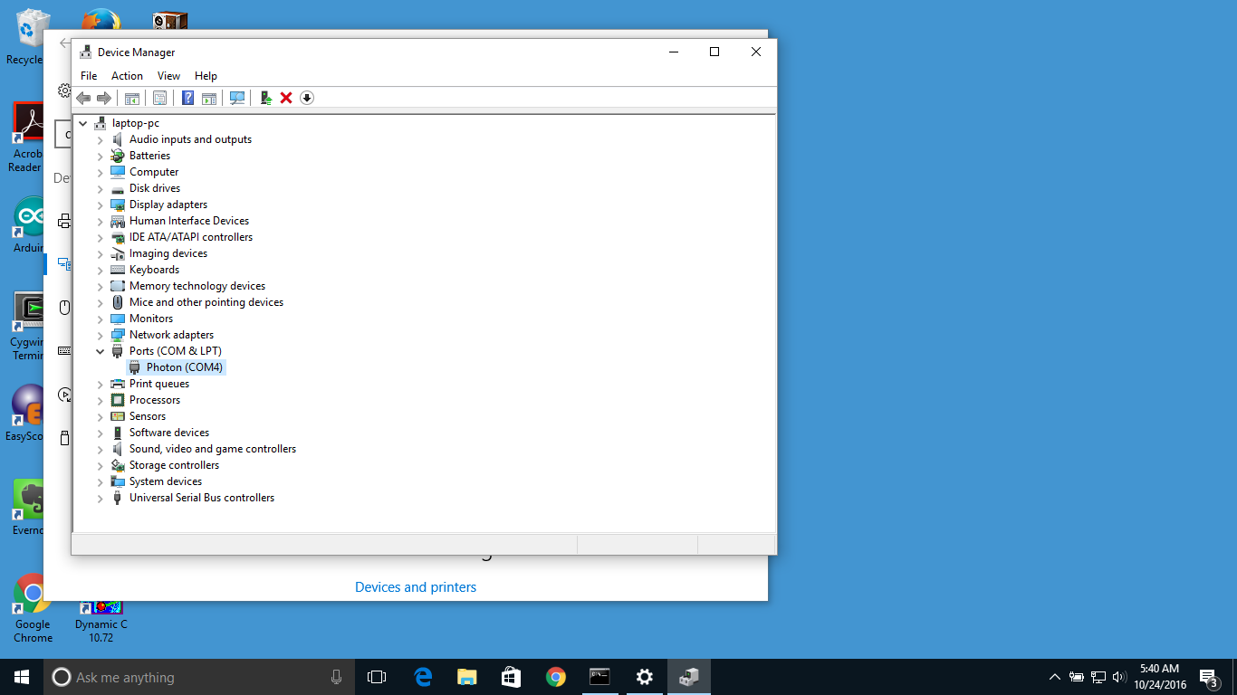

With the Photon connected by USB, open the Device Manager. It should show up something like this:
Another useful thing to try is to put the Photon in DFU mode (blinking yellow) by holding down RESET and SETUP, releasing RESET and continuing to hold down SETUP while the status LED blinks magenta until it blinks yellow, then release.
Under Windows, DFU and serial modes use different device drivers, so it’s possible for one to work but not the other. This can help narrow down the possible reasons for failure. That should look like this in the device manager:
Rick
