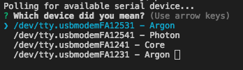

This is definitely a Linux command and will not work on Win10. You will need to reinstall as @ScruffR says above and then look in device manager under the USB section before you plug in the photon and then see what changes to find the port number it on. OR open a command prompt and enter
particle serial monitor --follow
once the photon is plugged in and it should show up looking like
Then just enter to select it, (or if there is only one found) it will automatically open a connection ...
Mine is on a MAC but in windows you will see a com: port number instead of "/dev/tty....."
