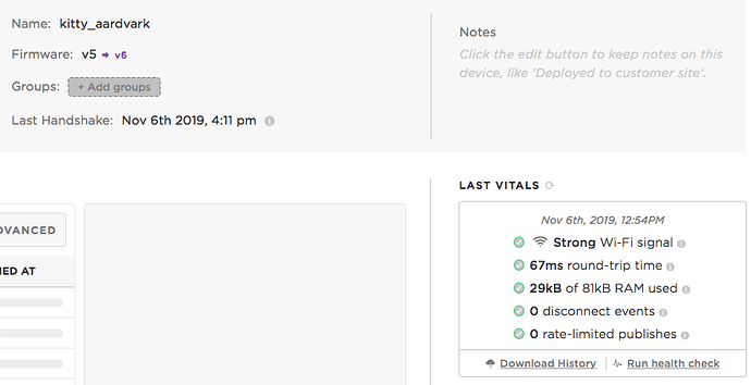

See this screenshot:
Some of them are on V5, even though V6 is out since 3 hours.
The only difference is the system firmware version (1.4.0).
Does someone know why they are not updating themselves?

yes, they have been connected for hours now.
They also are connected to WiFi reliably … here is a screenshot:
There is no interference possible from the users.

If you look at kitty_aardvark device in the console and click on Edit button do you have the device Locked or Unlocked for updates? Toggling the Lock/Unlock with Flash Now ticked will get the device updating immediately if that is what you want to.
Update - I have a remote command on all devices to complete what they are doing and then reset, I have found that since the Forced OTA feature in 1.2.1 this hasn’t been necessary to use.
It's unlocked.
When I toggled to 'locked' it immediately does the update.
