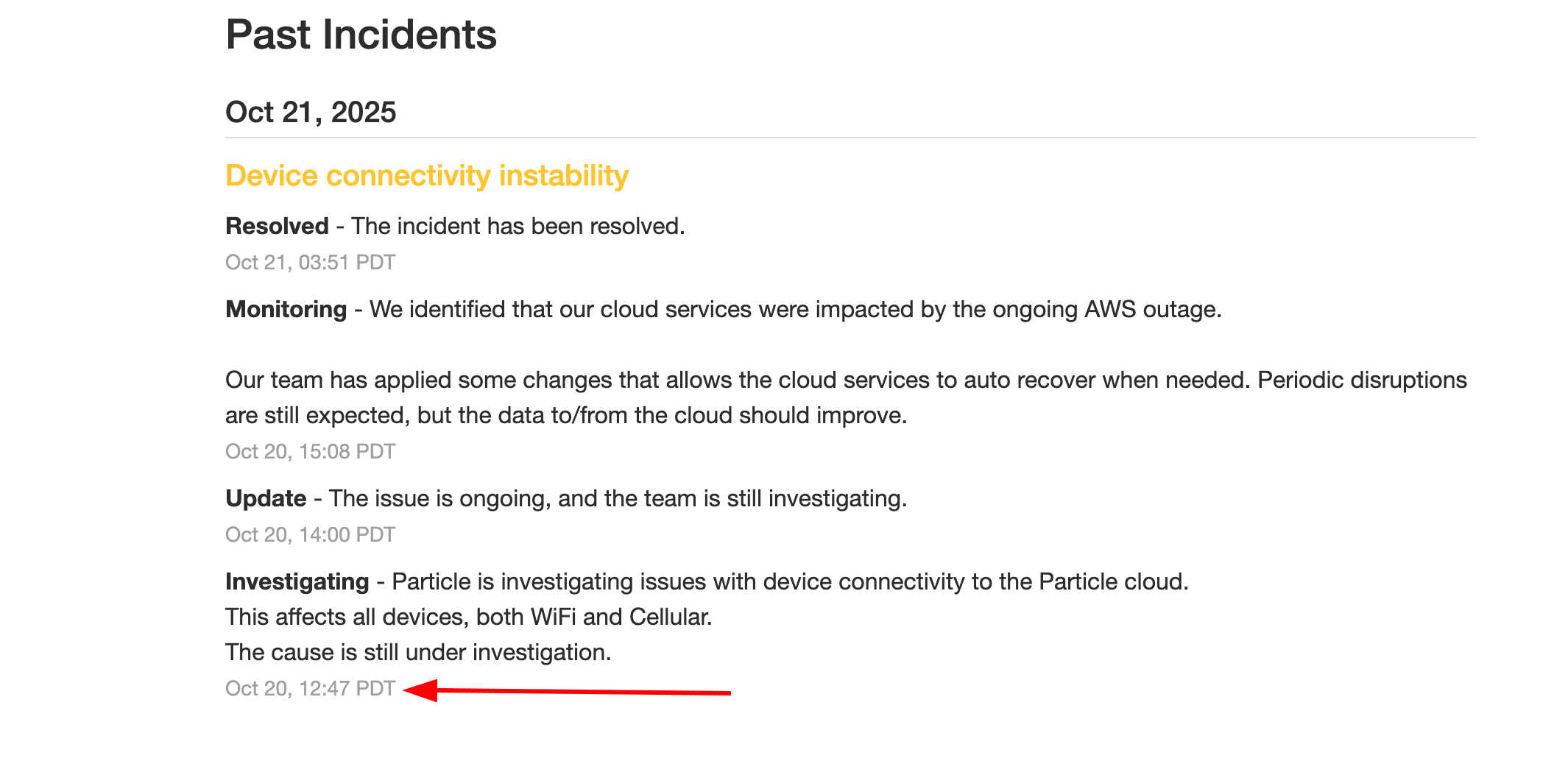

I’d like to close this topic.
Today I was able to get both devices to connect to the Particle Cloud
  1. Factory Reset
  2. Flash with Device Doctor
I had completed these steps multiple times previously - I can’t say what is different today.
there was an incident yesterday that may have impacted your devices, among others:
Best,
