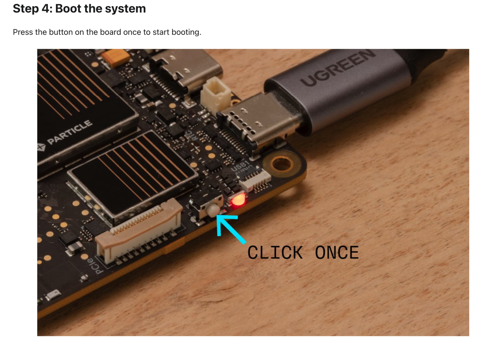

The terminal message should tell you to press the power button again - that will boot the tachyon. It should connect after a minute.
Unfortunately, it did not tell me to do that but i did anyway. Didn’t connect. Continued to flash yellow.
Hi, for how long did you press the power button? more than 3 seconds and the device enters the setup process (blinking yelow)
What if you press the button for 1 second max?
That was it! Held too long. That would have been a helpful note in the overall setup instructions (or did I miss it?). Thanks yet again Gus!
You’re welcome.
And yes, it’s there :wink:
