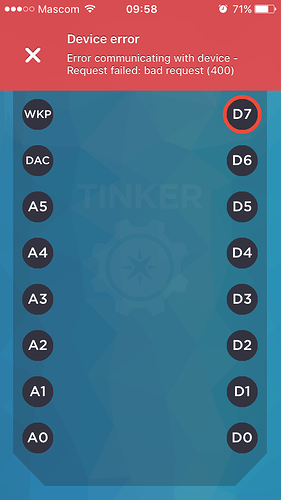

Trying to do a simple D7 LED control from the Tinker iOS app persistently fails with the error “bad request (400)” as shown below:
After a number of initial attempts, I did successfully get it to work once, but several successive attempts all return this same error.
Is anyone able to assist me with identifying where in the chain of communication between the Tinker app on my iPhone and my device this particular error is occurring?

Particle SIM cards have a really long keep alive interval of 23 minutes. 3rd party SIM cards can range from about 30 seconds to several minutes. What happens is if the cellular network does not get a keep alive ping often enough, it shuts down the incoming port to the Electron. This prevents things like variables, functions and OTA code flash from working, which is what you’re seeing here.
and in setup() the keep alive. This sets it to 30 seconds, but you probably want to make it longer to avoid using a lot of data. The specific value depends on your carrier.
