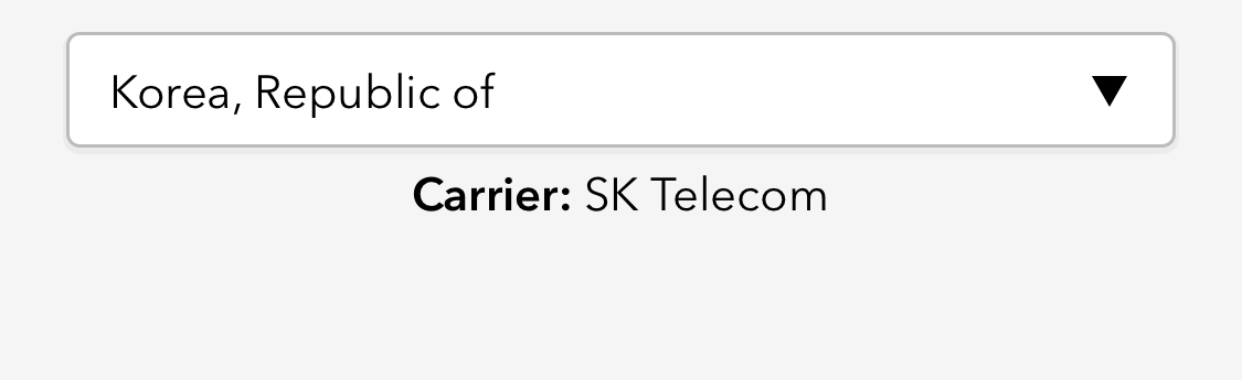

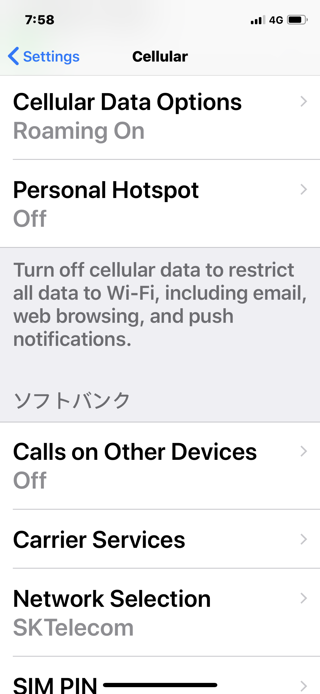

From what I read on particle web site, the particle sim uses KT telecom in Korea, and my phone shows the same network with full bars.
Is there anything special I have to do to get it working in a different country?
Do I have to make a separate account for each geographical area I will have devices in?

I gave the wrong information about the cell carrier in this area, it is actually SK Telecom. But phone gets good bars as stated.
That doesn't mean your Electron would get the same connection quality.
For one your phone shows a 4G connection but your Electron will most likely be a 3G version. Apart from that mobile phones have much more sophisticated radio modules than IoT devices.
Thanks ScruffR,
I did have the same thought and tomorrow I will take it to a different location here to see if the condition improves, but on the flip side - that I am in the area of a known service provider and yet still get no connection, it makes it difficult to use such information to determine feasibility of deployment and somewhat concerning.
