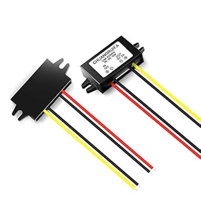

@Bspranger, loss of keys that often is most likely related to an under voltage condition on the Photon. Have you looked at the quality of your power?
I have not but I will. I am using a 12 volt supply with a 5 volt regulator to power the photon.
this is the device I am using:
@Bspranger, is the Photon always on or does it sleep? There are no specs for the product, including ripple and efficiency. Have you considered a higher quality unit from Pololu for example?
