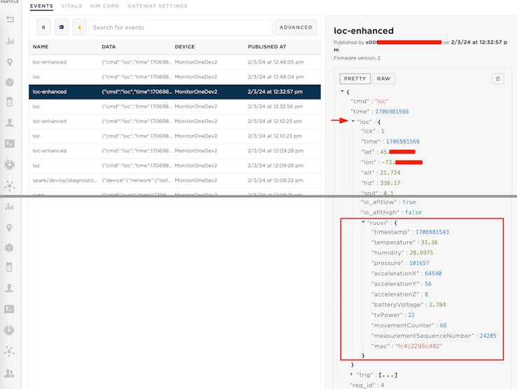

Use the Particle cloud console at https://console.particle.io/ to see it:

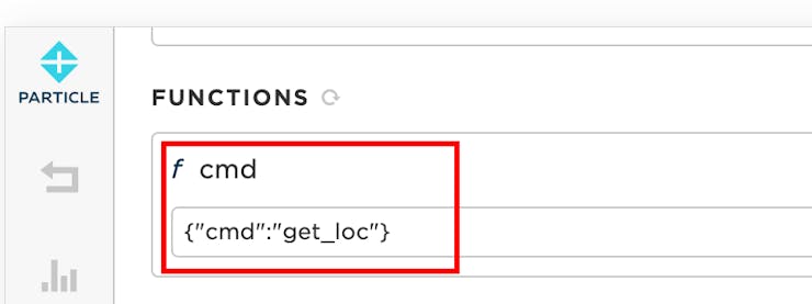

You can also request the information at any time with the {"cmd":"get_loc"} command:
