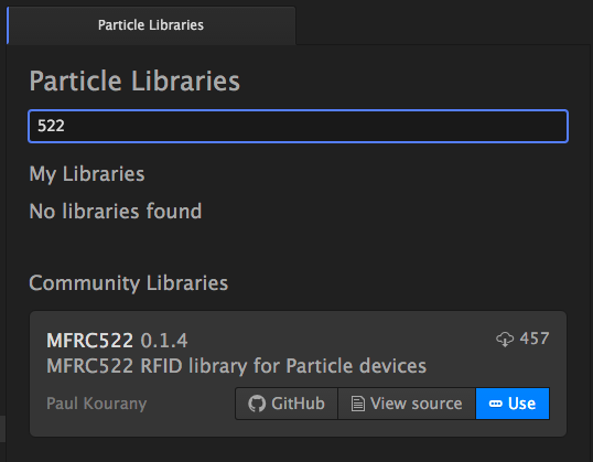

Hi, I seem to be having problems in adding libraries to an existing project using the desktop IDE.
After finding the library I’d like to include, I click the ‘Use’ button, but rather than being offered the option to include or copy the libraries to my project, the IDE just starts a new Project. Am I missing something? Photos included.
To use a library in a project you first need to have a project to add it to.
The behaviour you’re seeing is expected as long you haven’t got a proper project selected.
Hi,
Thanks for getting back to me. I do have a project, and added code to the main .ino file. It shows itself in the directory as well as shown in the screenshot attached.
But your Dev is positioned at ./Projects.
In order to have it function propperly you need to have ./Projects/egg./firmware/eggproject/egg as your base directory.
The selected directory is irrelevant, you need to File - Open Folder... the actual project folder.
Sure! Sorry that makes complete sense, it’s now working great. Thanks for your help.
