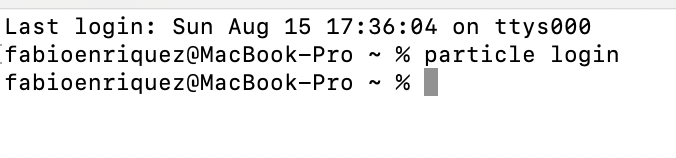

Hi @nrobinson2000 . Thanks for the tip. I enabled the Rosetta for the Terminal but still I get nothing. The particle commands just go blank.
Screen Shot 2021-08-15 at 5.37.18 PM
Any specific procedure I can do to start fresh? I.e uninstall and re-install things.
