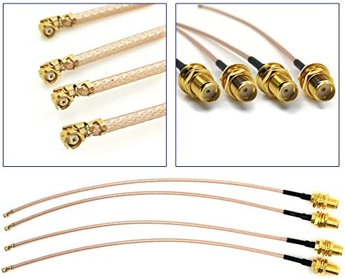

You will need to get the antenna outside of the enclosure, but done correctly, it would still be protected.
I have used several external atenna’s with this enclosure
and:
and:
You just need the adaptor:
