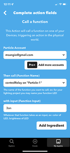

Hi, all I’m trying to do is mirror what I had setup using IFTTT directly - see example below which is the “then that” portion following a day/time “if this” command. I have a few more commands than the 8 (off/on etc.)

Sorry, I don’t quite understand, being a non-programmer myself. When you say "are you exposing a function 3on by calling Particle… well yes I am trying to i.e. trying to mirror what I had programmed in the IFTTT applet but getting confused with what to enter in the Webhooks parameters, including device ID and access token etc. How am I supposed to send an input command of “3on” to my particle-1 board as this is the command it requires to turn relay #3 on?
FYI I’ve tried putting url as https://api.particle.io/v1/devices/123456789987654332189/controlRelay
and Body as {“arg”:“3on”}, but I still get a
[Action failure message: Your server returned a 400. Unable to make web request to https://api.particle.io/v1/devices…] error
