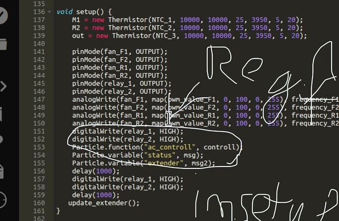

In your code and the Particle.function()
is registered in setup()
e.g:

Your function is not called lock but control - lock is the parameter.
It's the first parameter that is relevant for the naming of the exposed function in the cloud.
If you wrote
  Particle.function("remote_control",control);
You'd need to call remote_control from IFTTT.
