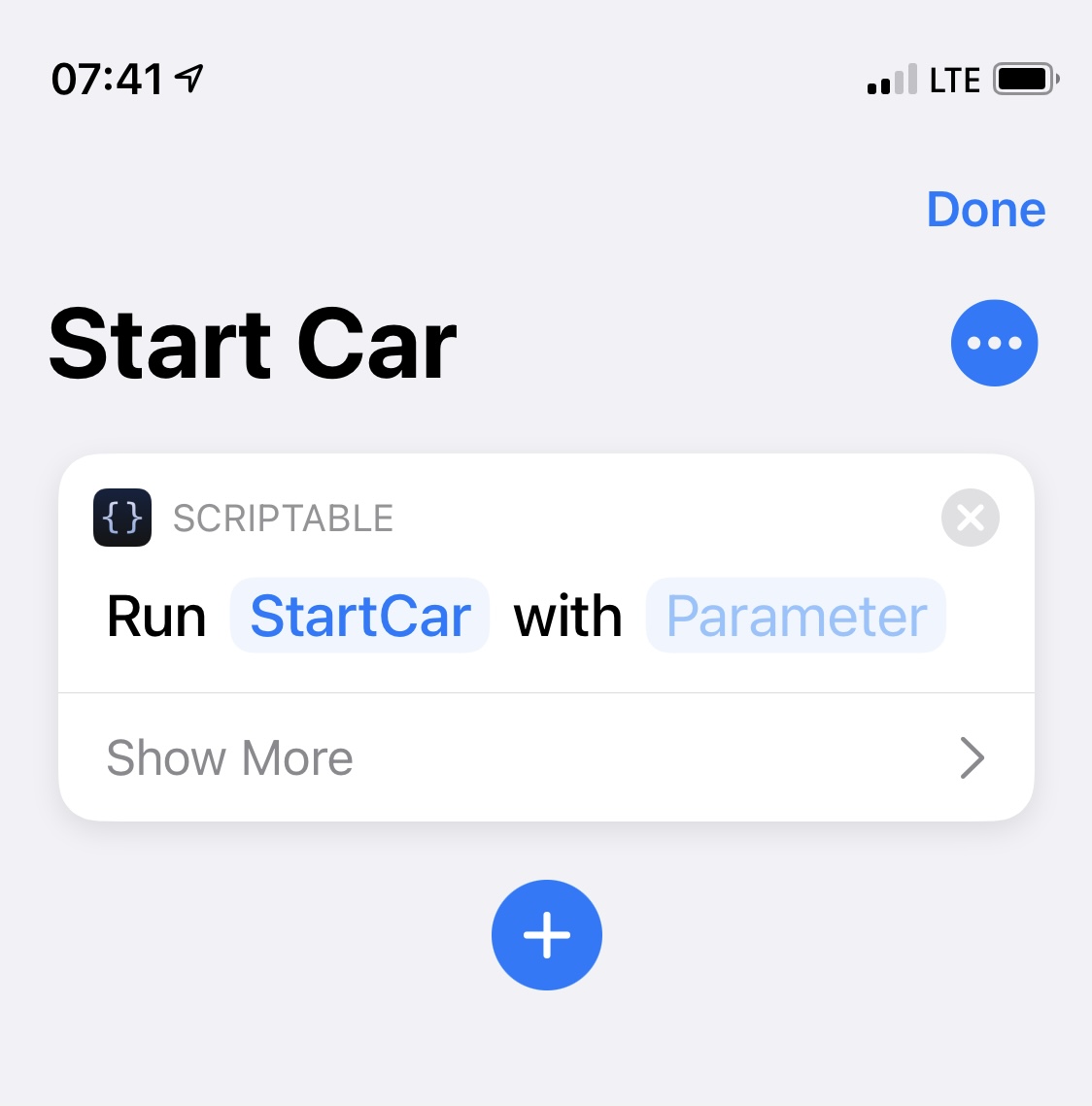

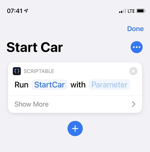

  1. go to Siri Shortcuts and add new then click “add action” and search for Run
  2. select scriptable Run script and chose apriobate script

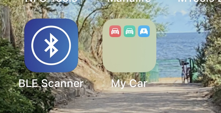

  3. save and add to home screen then on Home Screen add all 3 shortcuts to one bookmark rename e.g My Car and done.
