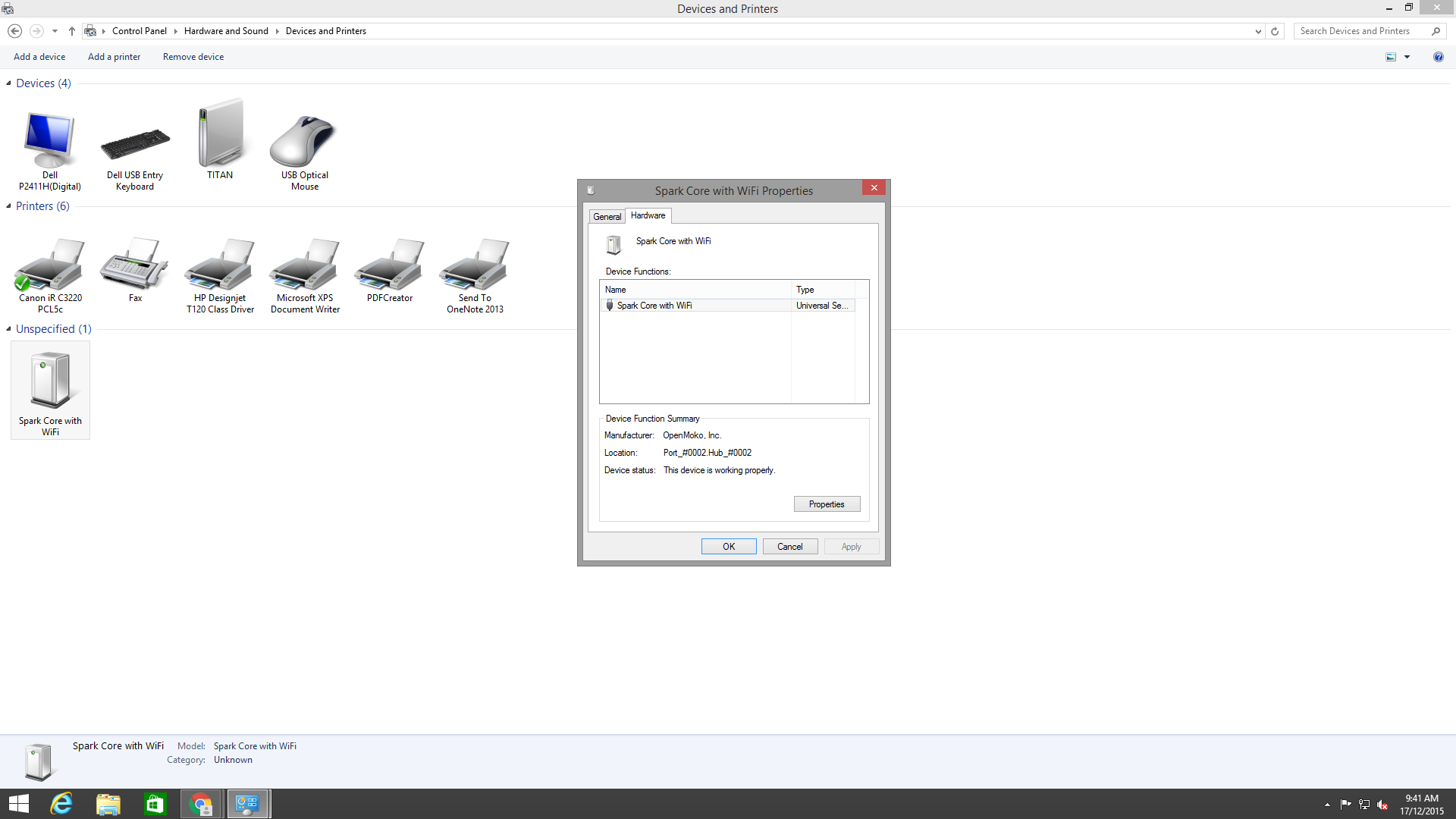

It came up as an Unspecified device in the device manager. Here is a screen shot of what it looks like in listening mode.
As for the serial driver is that what i installed with zadig?
Look at the docs for connecting via USB.
Zadig is for dfu driver :slight_smile:
That's the devices and Printers interface, not the device manager. Right click the start button to get there easily :wink:

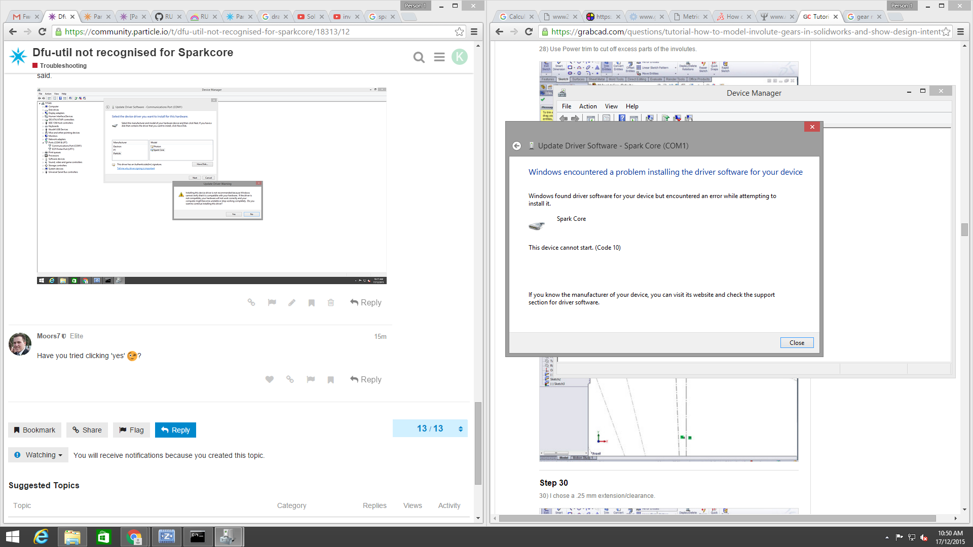

Thanks, i have followed this tutorial but instead of photon i have selected spark core but it comes up saying windows has encountered a problem installing the driver software for your device. And it says that this device cannot start. (Code 10). Is there something different that i have to do because it is a core not a photon?
Try deleting all drivers that are installed for it. Connect it in listening mode, and give it another try. That might help.

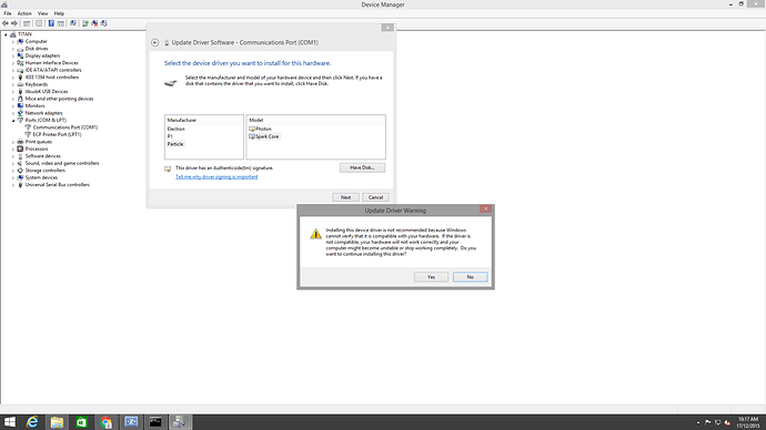

Just tried deleting it and redoing it and it did the same thing again. Here is a screenshot of what the message said.

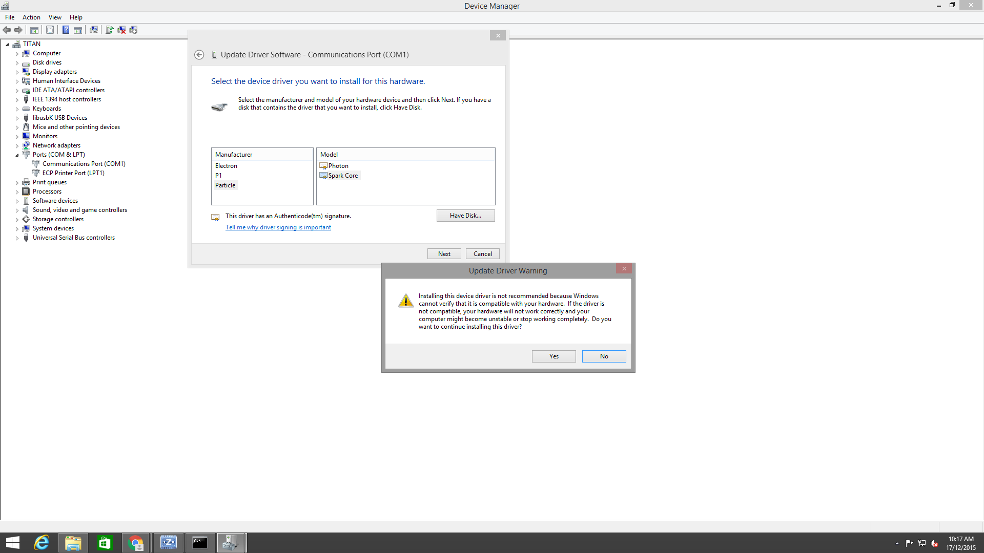

Have you tried clicking ‘yes’ ;)?
Yep, this is what happens
