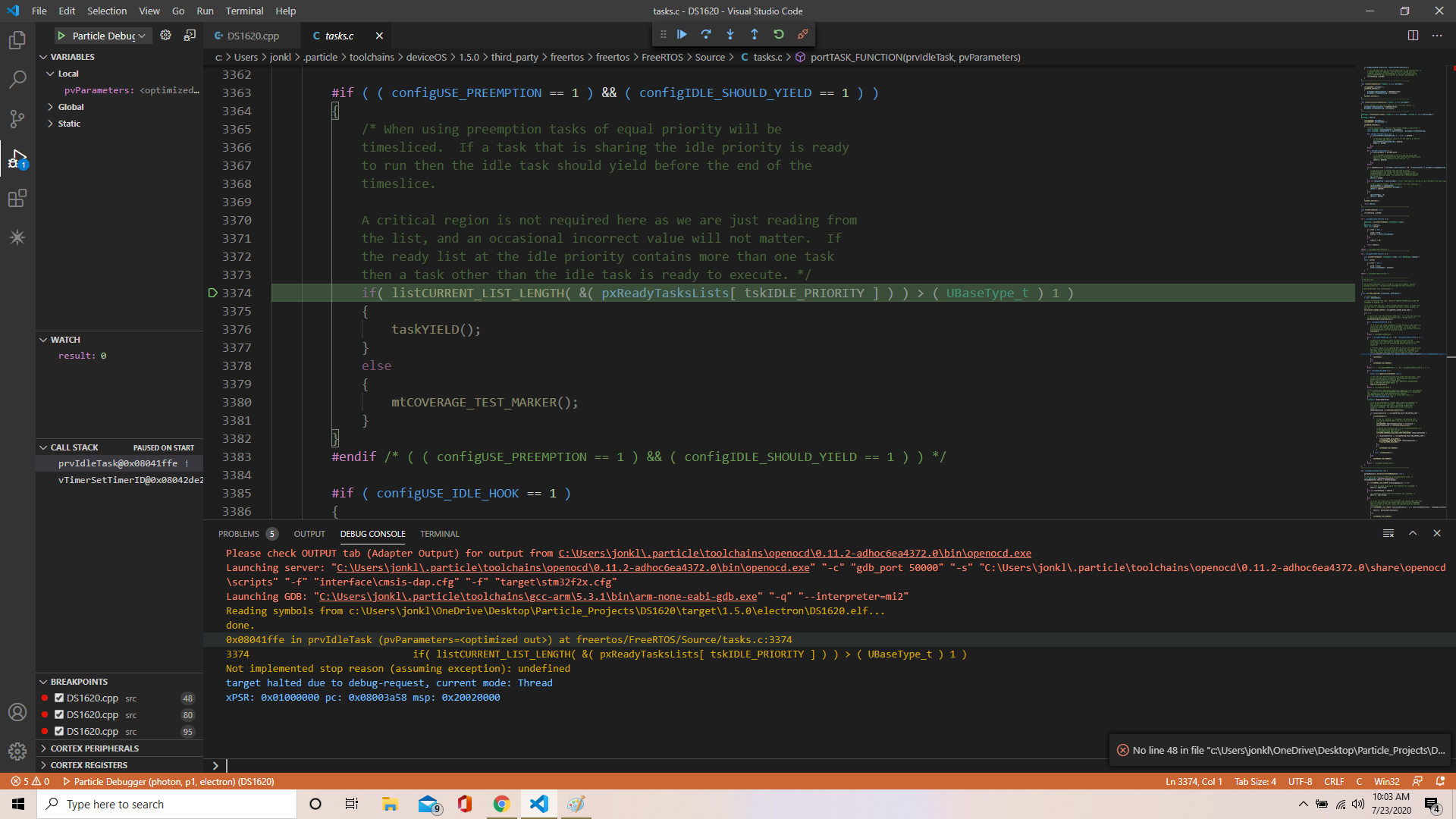

Just getting started with using the hardware board: Debugger with my electron. Can someone point me to the solution to clear my issues under PROBLEMS/DEBUG console. I’m a novice at this stuff, not sure whats going on. Sequence of events:
  1. Connected debugger to USB and Electron board via documentation
  2. I did do a clean application for debugger
  3. Started debugger and consistently get these 5 problems.

My code can compile/flash (locally) with no issues. However and maybe this is a cockpit error on me but the debugger does not seem to work. E.G. I would simply do a break point and do a restart on the debug console (upper middle menu) expecting it to break but it brings up another file?? There is still a learning curve but I’m not getting a good feeling its working correctly.
I’m still not able to debug at all. What else could be wrong
Hi @KB1DC, the debug function looks worked in the picture. The errors you posted are something related to the PATH setting.
