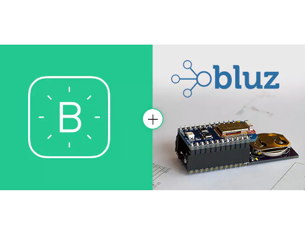

Hey, for the ones that can connect to a GW, I had a lot of fun with my BLUZ long time ago when I connected it with Blynk.
Blynk may open posibilities for your students, so here's the project I did in case it helps:
