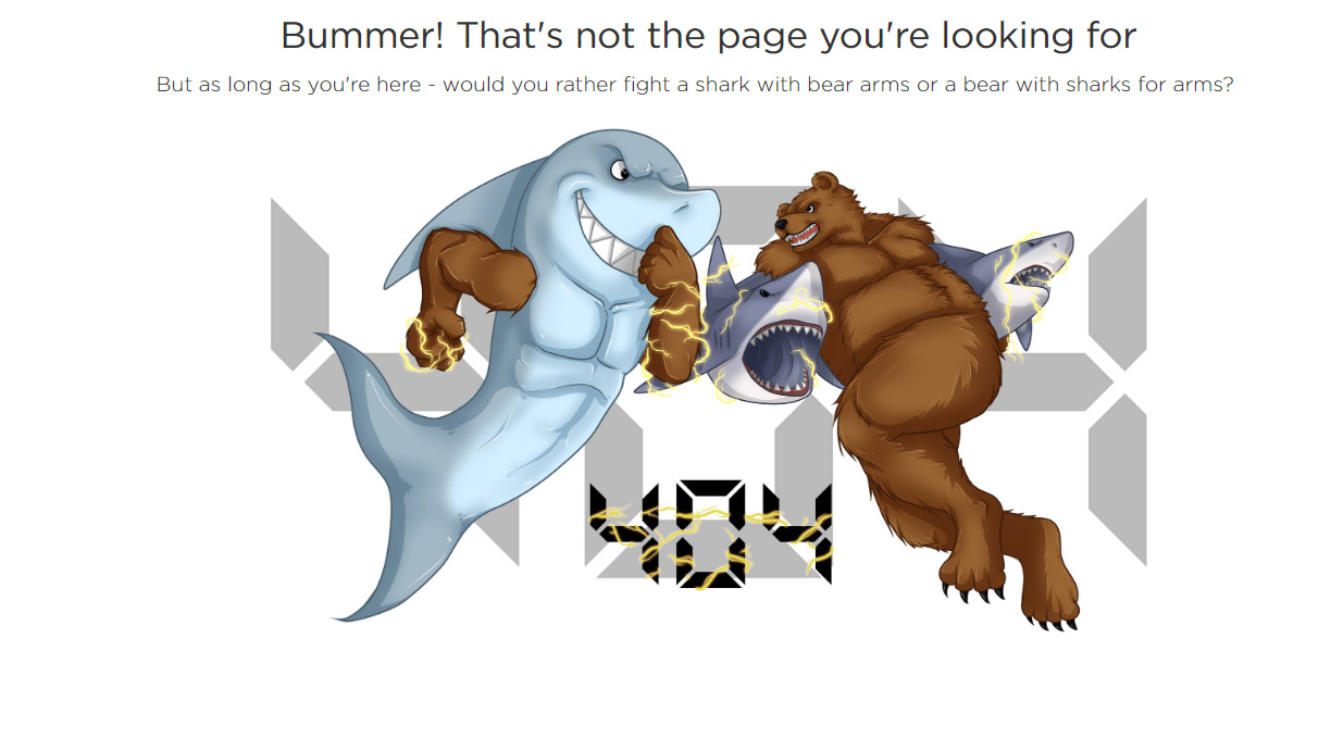

And I’m getting this for the console pages…
Bummer! That’s not the page you’re looking for
But as long as you’re here - would you rather fight a shark with bear arms or a bear with sharks for arms?
(This was mildly amusing the first time… but now its just annoying…)
