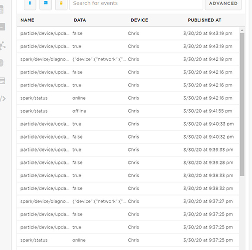

Yes it shows, as you can see I get updates from the events, although clicking the exclamation mark only makes the colours in the WEBIDE cycle, the argon keeps breathing cyan. Forgot to say, it also goes from breathing cyan to flashing cyan like it’s trying to get a connection to the cloud server.
