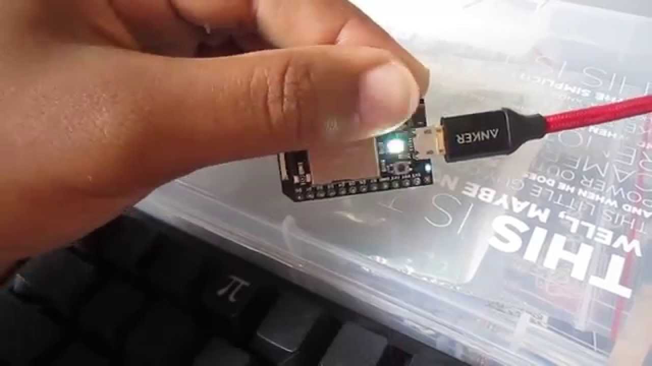

@futurebird, what happens when you factory reset the core?
When I factory reset it flashed yellow, then white very fast. Then it goes to breathing cyan/ or white. It never goes blue. I can’t detect it over wifi with my phone or over serial OR wifi using CLI.

Anyways, can you take a video of the factory reset process?

Here is a video of the factory reset process:
(EDITED: to make it more clear what the video is for.)
@futurebird, you are holding the mode key for too long and putting the Core into factory reset. For the particle flash commands to work, you need to let go the mode key when the LED is yellow (before it turns white). Then try particle flash commands. :smile:
