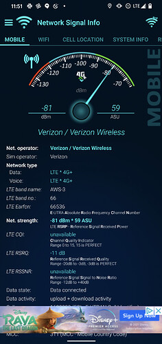

2021-04-12_23_41_24
If you look closely enough into this low quality gif you can almost see my soul breaking, also a banana
This is from my phone sitting right next to them.
Finally, as you can see- the antenna is quite unencumbered by anything at the moment and still having problems.

Very sorry to hear you are having these issues. In your phone screen shot, I noticed the carrier is Verizon. Do you have a way to check AT&T or T-Mobile as Particle devices do not use the Verizon network.
Thanks, Chip
