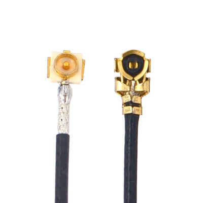

I just wanted to say that there are u.fl cable extenders on ebay and elsewhere. This does not solve your certification problem, of course.
