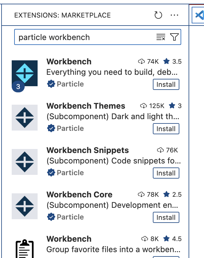

It was updated on October 1. It is a preview release, so make sure you've enabled pre-release versions.
There was also an issue with a release of VSCode over the weekend that prevented a number of extensions including Particle Workbench Core from updating. If you have a VSCode update pending, update that first. Then make sure you don't have a Workbench update pending.

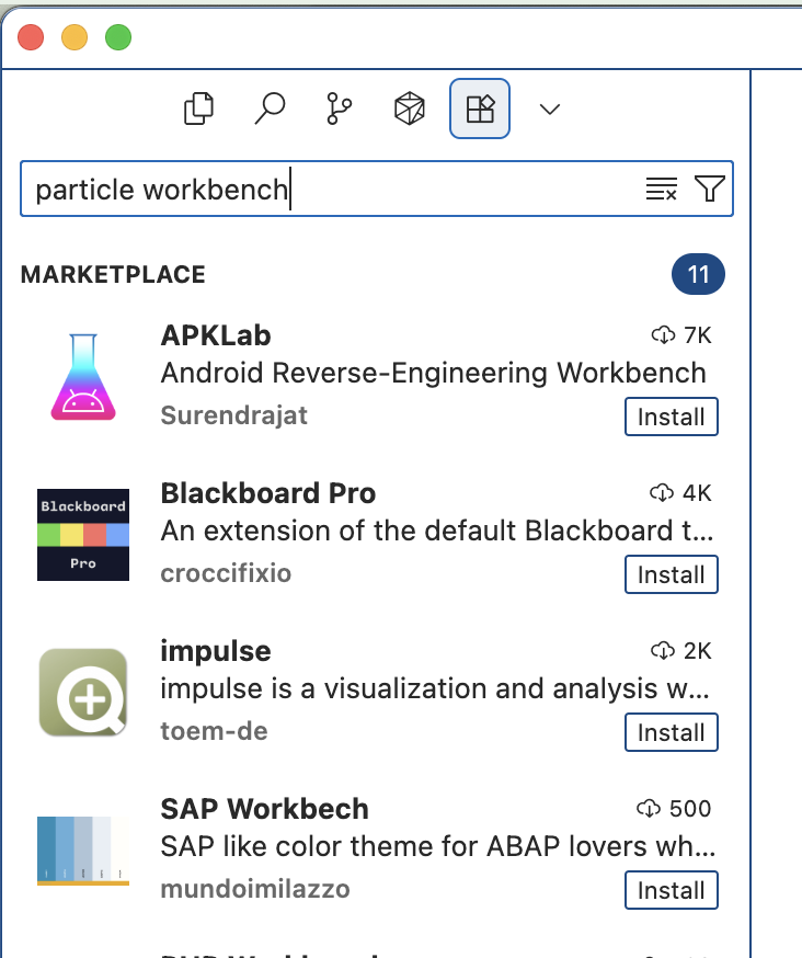

This is the issue: I am using Cursor.
vs-code
The Workbench extension isn't compatible with Cursor at this time.
My unofficial work around for now
Download the VSIX Downloader - Download Visual Studio Code Extensions | Free Online Tool
-Particle workbench
-Particle theme
-Particle core
Drag these .vsix files into the Cursor Extension Tab
Confirm these have uploaded
