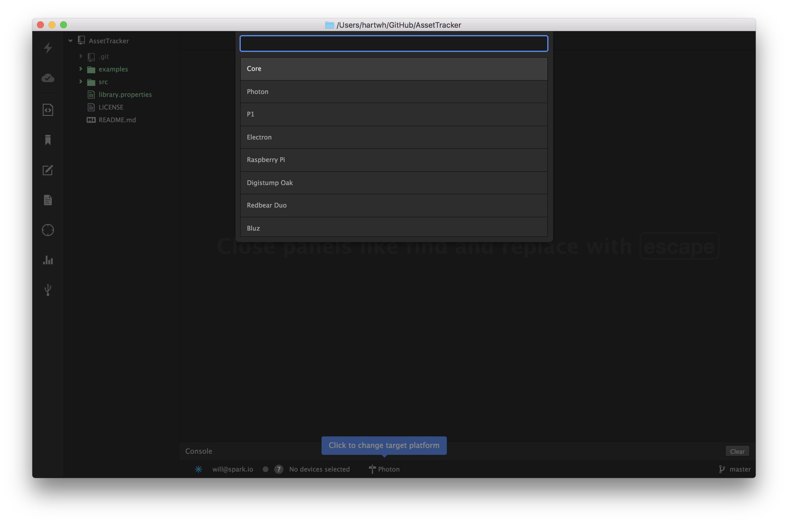

There is a hyperlink at the bottom of the application interface that you can use to change the build target. Let me know if that works for you!
That isn’t quite it. I need to be able to specify exactly which firmware version for Bluz. For instance when using the CLI:
this fails:
particle compile bluz
but this works:
particle compile bluz --target 2.1.50
I am assuming that by default it is building against 1.1.47 both for the CLI without the --target option, and in Particle Dev. So basically there doesn’t seem to be a way to specify the exact firmware version to compile against from within Particle Dev.
