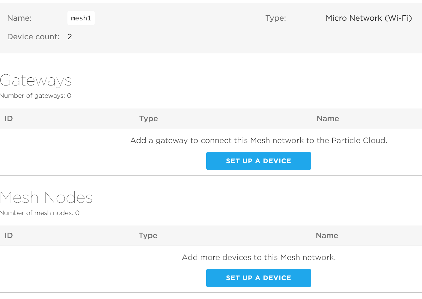

You have absolutely no device assigned to the “old” mesh and it still shows up (with Total device count 0)?
Can you post screenshot of console.particle.io/networks/[yourMeshName]?
Claiming is separate from mesh network membership. Until you add the devices to a different mesh network, the network will continue to exist on the old account.
Claiming only affects what user is the owner of the devices, can OTA flash it, make function calls, etc… It can be different than the mesh network owner if you manually unclaim and claim. The mobile apps generally force the network owner and device owner to be the same, but it’s not actually required by the devices.
You seem to have found an oversight in network management :wink:
Obviously a device that is not claimed to your account won’t show up in your console but since we don’t have a simple way for a mesh device to leave a mesh network without joining another you apprently can’t just move a device to another account without leaving traces.
As it seems to close/remove a mesh network all clients need to leave the network, but unclaiming the device only makes them vanish from your account without the the extra steps needed.
