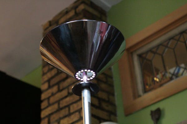

I think this version is not interrupt driven or anything fancy, but this lamp project uses a rotary encoder:
spark-torch.ino is a program that runs as firmware for the CloudLamp. It uses an array with brightness values to have a dimming curve approximated
as (e^x - 1) / 1.578. It also has a spark function "turnTo" that allows for remote dimmability. The light engine is two Adafruit Neopixel LED boards.
