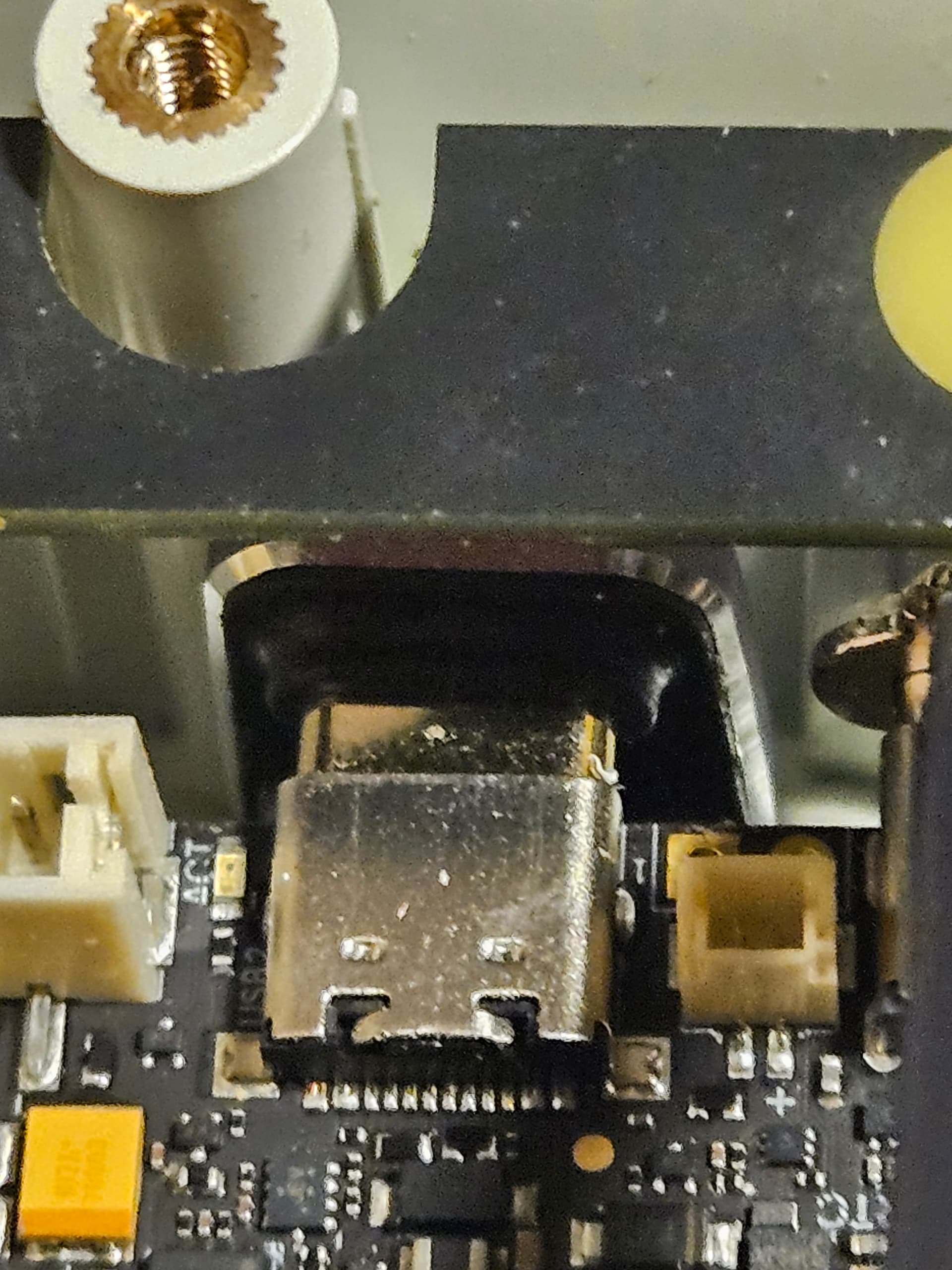

After several challenges got it up and running only to forget which password I created. How do you connect to the cases button. Was there a cable provided?
Also how do you deal with one of the case posts blocking the second usb port
I’m not sure but in this case running setup again might be needed.
What do you mean? What case?
I am unable to fit the second usb-c as it’s blocked by a lid mounting pilon
hey, sorry, I’m not familiar with that case. Maybe if you post full details about someone from Particle can help you sort it out?
Hey JayC,
We use something like this internally:
There are all sorts of cables that have a flat USB-C on the end of it and then various termination options - hope there is one that matches your requirements!
(the reason we are using flat cable heads is that we found unless we make a box that is extremely wide, USB-C cables could not plug in due to the connector and strain relief end needing up to 2.5” of space, depending on which cable you were using, we went with the adapter model. cables start at around $3 depending on your source)
