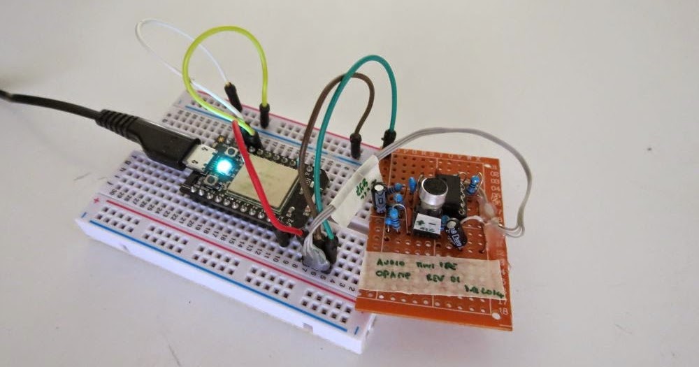

here you can find my library to to retrive RMS and Spl value from an audio input.
Library is published as: audiogetaveragelib
More info and github link in the blog post here:
Hope this helps!

Hello,
you can take a look to this FFT library and port it to particle, I’ve tested it on ATmega and it works quite good, also it doesn’t use a lot of resources.
