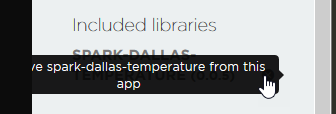

An additional vexing problem with the updated interface: I am unable to remove the library because the remove X button is covered/blocked by the message box that says: Remove spark-dallas-temperature from this app.

Can I get a screenshot of the covered “X” button?

Here is a screenshot exactly capturing the situation on FireFox. You can try to click the X, but it just doesn’t register.
Ok… so… there are TWO screen shots. heh. Thanks for looking into this.

I think the real problem is that it is possible to lock the application by just adding a community library. If the remove button worked, the user would have several options for mitigating the problem. The root course is a simple error in the Web IDE. May bee it is easier for all, if Particle just fix the error ?
About the remove button I was able to have it show with FireFox and a small zoom factor or reduced font size, which allowed enough space for the remove button to appear and not be covered by the tool tip.

It never crossed by mind, it could be just a “display” problem".
I used Chrome, zoomed in, hit the remove button, and zoomed out again and confirmed. Perfect.
