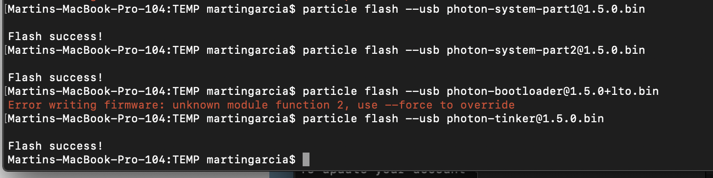

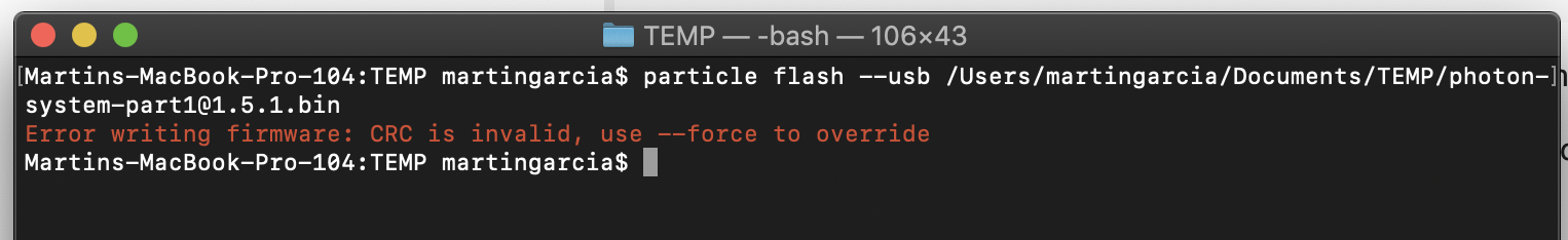

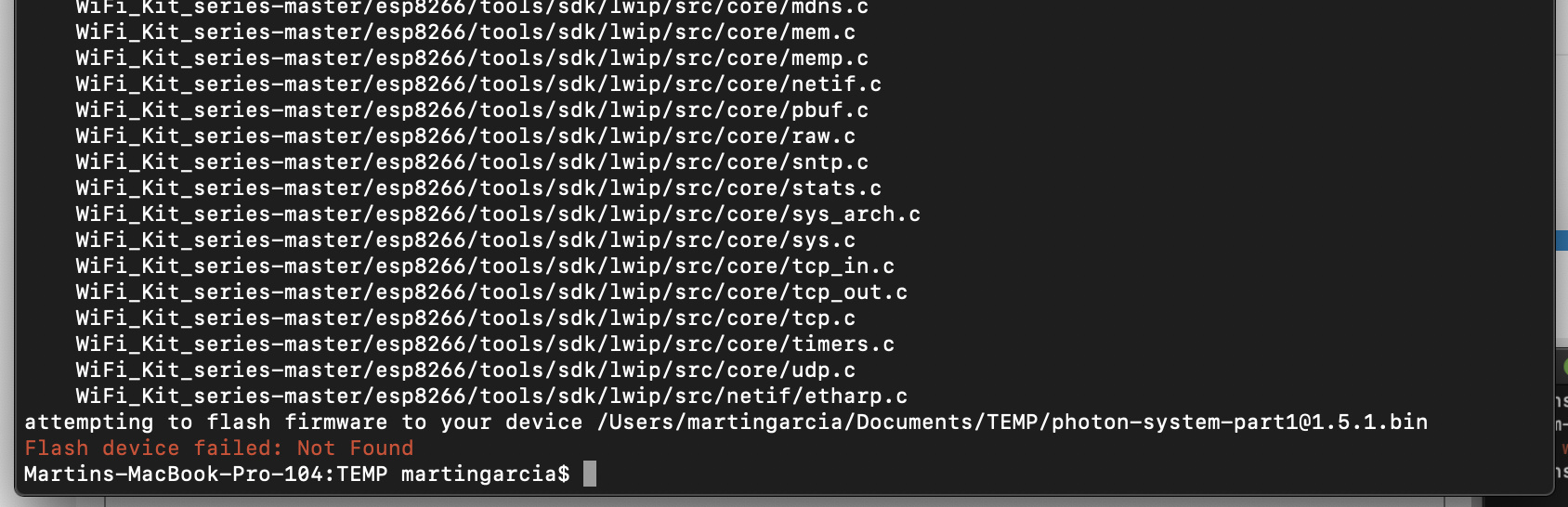

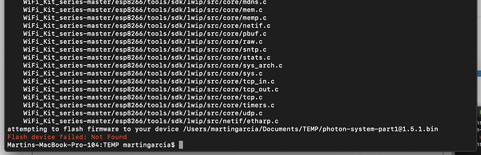

My photons are completely useless, they were able to run the softAP flawlessly and now, even with much more free RAM, they just wont work.
Also, do you have some guidance for reflashing the firmware? neither particle doctor nor the particle app work. This is something quite disappointing from Particle, this should be bulletproof and it is not.

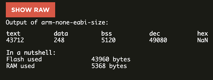

This is my ENTIRE code (first half)
You only need to add the Sparktime and ds18b20minimal libraries.
It basically reads a sensor for a few seconds and depending on what it reads it publishes to the cloud.
If I press a button it publishes right away, if I press it for longer it deletes the counter and resets it to cero, and if I press it for a bit longer it deletes wifi credentials, goes into wifi.listen and runs softAP.
Everything works as expected except for the softAP.
Is it RAM? I doubt it it since my code is very basic.

Sure, are you using OSx or Windows? I am using OSx do here is is what I did.
  1. Download the four files I mentioned form Github. Make sure to download both Part1 and Part2 for photon firmware.
  2. Install and update Particle CLI on you computer
  3. On OSx... open Terminal (or CLI in workbench)
  4. Connect device to you USB port
  5. Make sure devices is in DFU mode (flashing yellow)
  6. In terminal type: particle flash --usb and then simply drag the downloaded files into the terminal (one by one) window. It will automatically enter te file name and path. The device should remain in DFU mode after each flash, unlike Particle Doctor.
  7. Hit Enter. When done, repeat with the next file, in this order:
You should see something like below:
Regards,

You mentioned you use softAP without problems, can you comment on how much used ram and rom you have on your projects when you compile (verify) them?
In my case i have about 44kb flash and 5.3kb of ram. Is this a lot? I dont think so.
I suspect the softAP runs out of ram when it is launched and starts behaving erratically and different every time, sometimes the softAP page on 192.168.0.1 never shows up, other times it does but no photon ID appears, other times I can scan wifis and enter the password but it just ignores me and keeps blinking blue.
thanks again! =)

i tried also with --force
I flashed tinker and it did work so the USB cable is ok.
i downloaded the binaries from: https://github.com/particle-iot/particle-cli/tree/master/assets/updates

Suspect the 5kb Ram is a problem yes, I have around 25kb available.
I just uploaded SoftAP and very basic 10 line sketch and total is ±37kB of RAM usage. If I combine that with in example the 38kB used by a Pump Switch and power monitor sketch (38kB) I suspect I might start running into problems as well, but I will combine the two and test.
From the screen grab it seems you downloaded device os 1.5.1?? I did not use these files, I used 1.5.0. Refer to the files below:
I downloaded them from THIS LINK If you want, you can give them a try?
Just off the top of my head, it seems Argon my be the way you want to go using SoftAP and larger applications. There are some concern that SoftAP can be a tad bit resource intensive, I am just not sure what the alternative is for WiFi connection. I know Blynk has a function called Blynk_Inject but of course this will mean you have to use Blynk as UI and it comes with a hefty price tag of US166 p/m.
There might be some clever guys that have managed to solve this in a different way, but I have not found them on this forum. Easy WiFi end-user setup seems to be a challenge for many.
Let me know ion the V1.5.0 files help. If not, might be worth submitting a support ticket.

Yes, the code only uses 44k of flash and 5300 bytes or RAM (according to the output)
So, I think there is a super hidden bug somewhere, which also affects the ability to flash the bootloader maybe?
