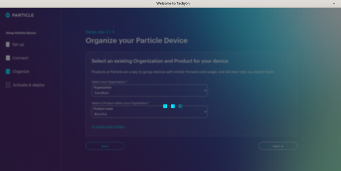

Hey everyone, I'm having a few issues with the setup:
During setup , it is stuck at “Organize your Particle Device” after picking the organization/product name,the 3 squres loading, did the sudo apt update and upgrade , rebooted but nothing.
Also my light seems to always be green but not quite cyan or magenta (wifi is connected) is there something else I’m supposed to be doing?
At device page eSim says not installed, is that something related to the stalled startup?
Thanks
