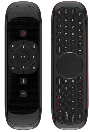

Dummy Outputas an option in Settings->Sound->Output Device. - Tachyon seems to crash while trying to use the keyboard below, it consists of a dongle and seems to work okay if I use it as an air mouse, but once I flip it to use the keyboard, the tachyon becomes unresponsive and blacks out the screen after around 2 mins (works perfectly fine in RPI4), Logitech keyboard with built in touch pad works perfectly fine.
