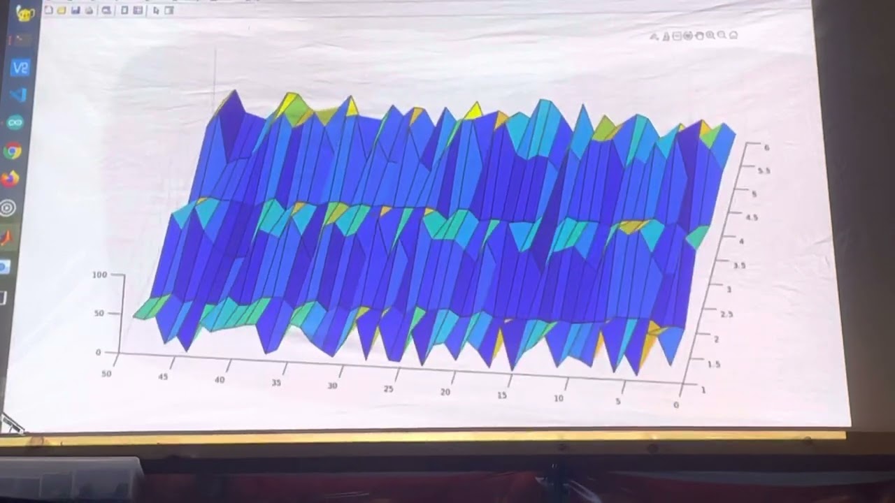

By the way I was able to get all of the rand() data (from previous example code) every 1s. and plot over 3D area it's preaty funky ! and now I know that Matlab is a monster !!! what is really nice that after you collect some data over time (in this example is set to 240 semples every 1s.) you can analyse the entire data after stop the script !
here is a Matlab script:

You can play arround mark surface unmark plot etc.
here some resultss :
I know that professional Matlab users gonna kill me one day but this is my 3th day with Matlab so after a little learning will be better ![]()
I hope that help
