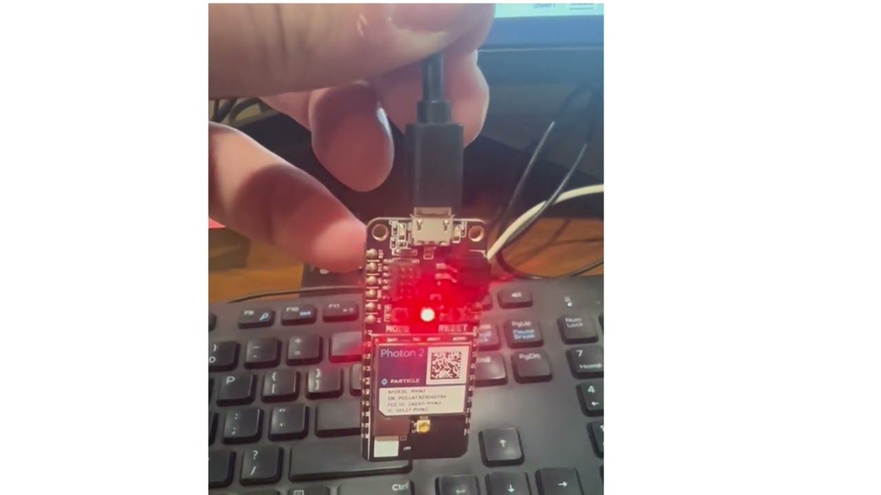

  1. About 1/3 of the time the configure-wifi developer tool caused the Photon2 to red SOS. This normally happened when configuring a second/different WIFI then the first. It would SOS for 2 maybe 3 sequences and then reset. When it reset it was happy again though. I am pretty sure it was 10 blinks (Assertion failure) but not 100% sure. This happened 3-4 times maybe 1/3 of the time that I tried it. I’ll try and gather more specific info or maybe a video of that would help.

As for item 1 (SOS):
Here is the info that it shows. This was brand new Photon2 out of the box. First configured using the setup.particle.io and then I wanted to play with WiFi setting capability further so I used the tool. I never flashed my user firmware to it yet so it only has tinker.
Here is a quick video of the behavior. As you’ll notice, it does still connect after it resets. Normally I get the red SOS to happen when I first clear the credentials and then set them again either to the same SSID or a different SSID.
