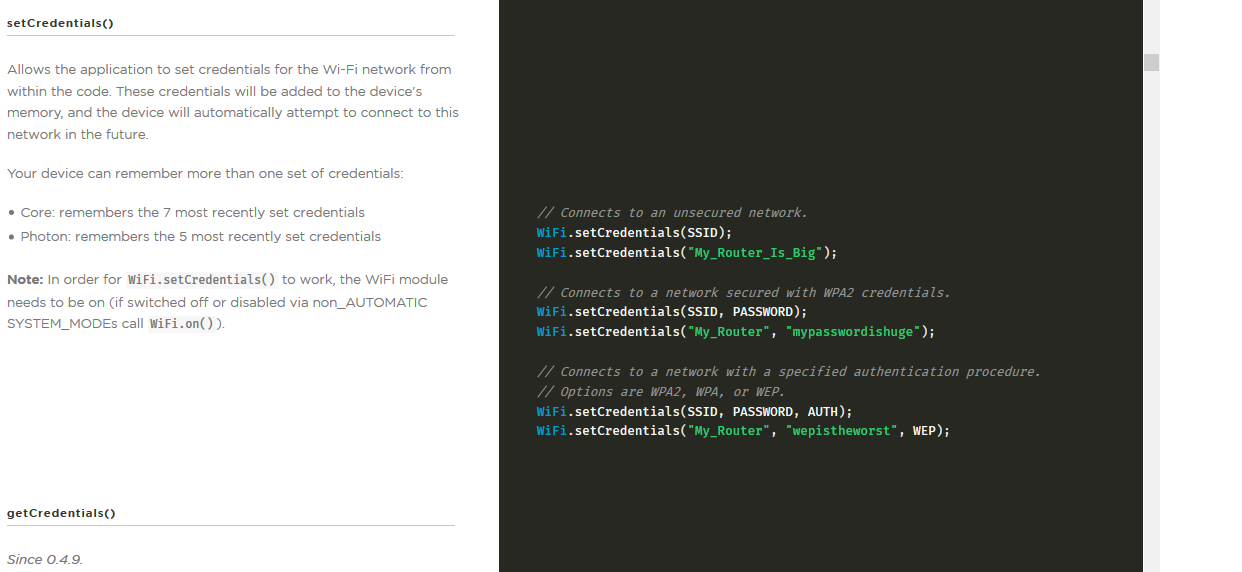

You can do that in code, which is described in the docs. Have a look :wink:
https://docs.particle.io/reference/firmware/photon/#setcredentials-
For your use case you need to use the four-parameter version of `WiFi.setCredentials()’ which also takes the WLAN cipher (which you need to know too)
e.g.
WiFi.setCredentials("SSID", "PASSWORD", WPA2, WLAN_CIPHER_AES));
But you can also use
particle serial wifi
or any serial terminal with the ‘w’ comnand in Listening Mode (both without scanning for the target network)
After setting SSID and the encryption type you’ll be prompted for the WLAN cipher if the network can’t be found.
