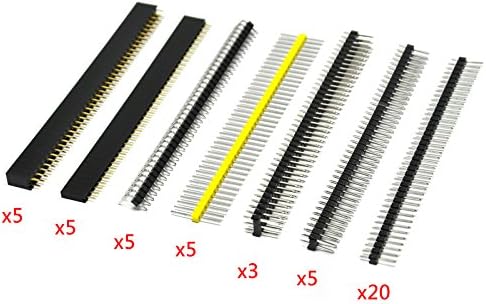

Links below are the boards and headers I’m using. Pardon the bad soldering job. This is my third attempt on the same board so it’s gotten kinda Fugly as my frustration has increased.

At first blush it seems that your SPI pins going to the RFID are incorrect, assuming you are using hardware SPI. Also, I don’t see a GND or Vin/3V3 going to the RFID connector either. If possible, you should try and use different color wires to designate power, GND and signals. Is the Electron sitting in a set of female header pins or directly on the board?

For power, I’m using digital pins via this tutorial so I can turn off the RFID module to save power, and the Electron is sitting in female headers. I couldn’t find a socket anywhere local and didn’t/don’t know how to spec these out so the slapping some headers on there was the quick-path to the get-go.
