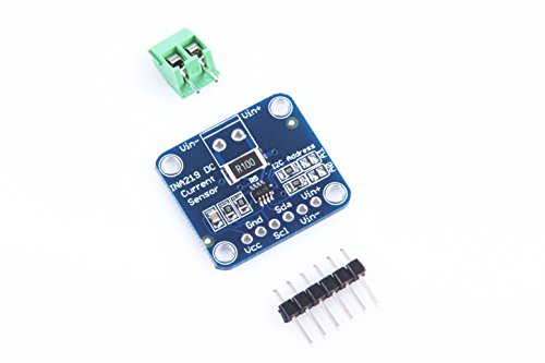

Here is the cheapest INA219 voltage current sensor I could find for you.
