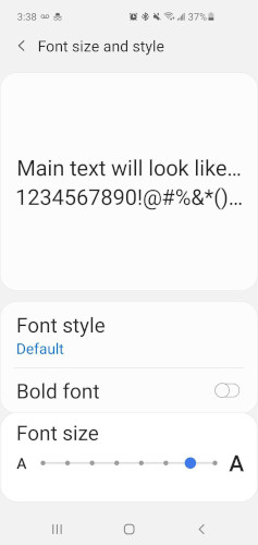

To replicate this I am using an samsung s10 and set the font size like the image below and launched the sdk.
