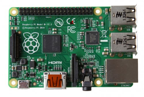

WOW! Just in time for this? No specs upgrade… just more IOs etc. :wink:
I’m excited that now the stuff like HDMI and Video out is removed which makes it more like a commodity hardware server style :smiley:
