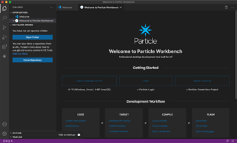

@m_m thanks for reaching out to me! See below the results, I hope this is more helpful to you than it is to me :wink:
From VSCode’s main menu, select “Help” > “Toggle Developer Tools” then when that panel appears, switch over to the “console” tab, try to launch the “Welcome” screen, and look for any interesting errors.
This is what I get:
Activating extension 'ms-vscode.cpptools' failed: Cannot find module '/Users/Tim/.vscode/extensions/ms-vscode.cpptools-0.29.0/dist/main'

hm. ok, that does shine a bit more light on things - thanks :+1:
here’s the root cause:
Require stack:
workbench depends on that extension (as do many others as you can see) so it fails to load as well.
a quick scan of the issues over in https://github.com/microsoft/vscode-cpptools shows a few perhaps related items:
TL;DR - try this:
  1. disable all extensions (docs) except for these:
ms-vscode.cpptools
marus25.cortex-debug
particle.particle-vscode-core
particle.particle-vscode-pack
particle.particle-vscode-snippets
particle.particle-vscode-theme
  1. if you are on a corporate network with unknown restrictions, etc. and able to, try connecting from a different, less locked-down network (iow, let’s rule out proxy-related weirdness if we can)
  2. try reinstalling (docs: 1, 2) and / or downgrading (docs) the ms-vscode.cpptools extension
let me know how it goes :pray::+1:
@m_m thanks for looking into it!
Uninstalling ms-vscode.cpptools and installing it again finally did the trick for me: after that, the installation of the particle workbench took much longer than just a few seconds during my previous tries. I guess w/o ms-vscode.cpptools working properly, even the installation of the particle workbench isn’t working as it should.
Anyway, thanks a lot for your help :slightly_smiling_face:
