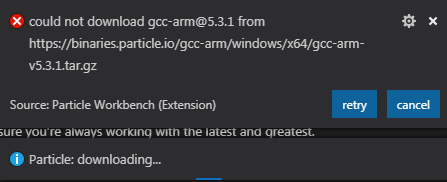

[ISSUE] could not download gcc-arm from behind proxy
I'm getting this error:
My PC is behind a company-controlled proxy and I always have issues downloading and installing new tools if they were not designed with this use case in mind.

Sorry to hear that, @Dillon1337! Can you try out the recommendations here?
Unfortunately, those are’t helping. I tried --proxy-pac-url= and --proxy-server= even starting them from a administrator prompt.

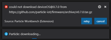

I’m getting this message now (which I am guessing just means that it’s trying to download this file first instead of gcc-arm like before):
I can search for extensions in the Marketplace, so it seems as though Code can generally access the internet, just not the Particle extension specifically.
