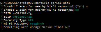

Hi, no difference in led whatsoever, the message 'it doesn’t look like your photon has made it to the cloud yet.
typed in particle serial wifi
it asked if i wanted to scvan for nearby wifi- said no
command prompt window did nothing. led went solid blue
pressed reset and led flashes green
put back in to listening mode
could do nothing with command prompt window, so pressed ctrl+c
terminate batch job-said no

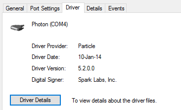

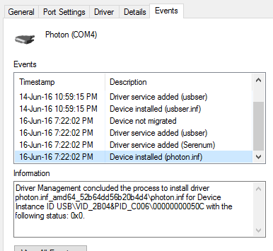

com 4 is reporting as
detial within it is

I can’t really see anything wrong with the drivers, so it might be something with CLI permissions.

run as administrator
when i said no to scan, led went out, once all credentials put in, it started flashing green, then came up with message below
Then went back into listening mode on its own
