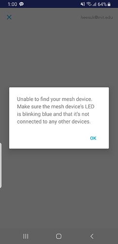

But here I found that the app doesn’t let me claim the boards to the test account, saying the error message below:
So I did the factory reset and tried to claim it again, but got the same error message.

At that stage the claiming state of the device is not even considered since the phone app hasn’t even started talking to the device.
Just to reiterate what the app is asking: Is the device actually in Listening Mode (blinking dark blue)?

I found how to fix this issue: just rebooting my smartphone! Unbelievable… I think there is a halting state somewhere in the smartphone-side network interface, and it was blocking the paring procedure. It’s stupid, but I’m very happy to make it work again. Thx @ScruffR!!
